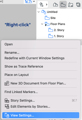

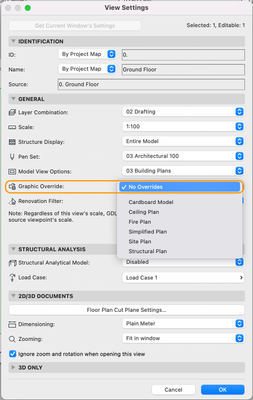

You need to redefine the View.
Either right click on the View in the View Map > View Settings > Graphic Override and change it to the saved combination you want to use.
Or right click on the View in the View Map > Redefine with Current Window Settings but note that this will redefine the View for all settings that differ between the Window and the View.

You need to change the settings of the view which you want to place/have placed in the layout.
In the View Settings dialog, go to Graphic Override and assign the desired one, then save it. Back in the layout, update the drawing (right-click > update).
