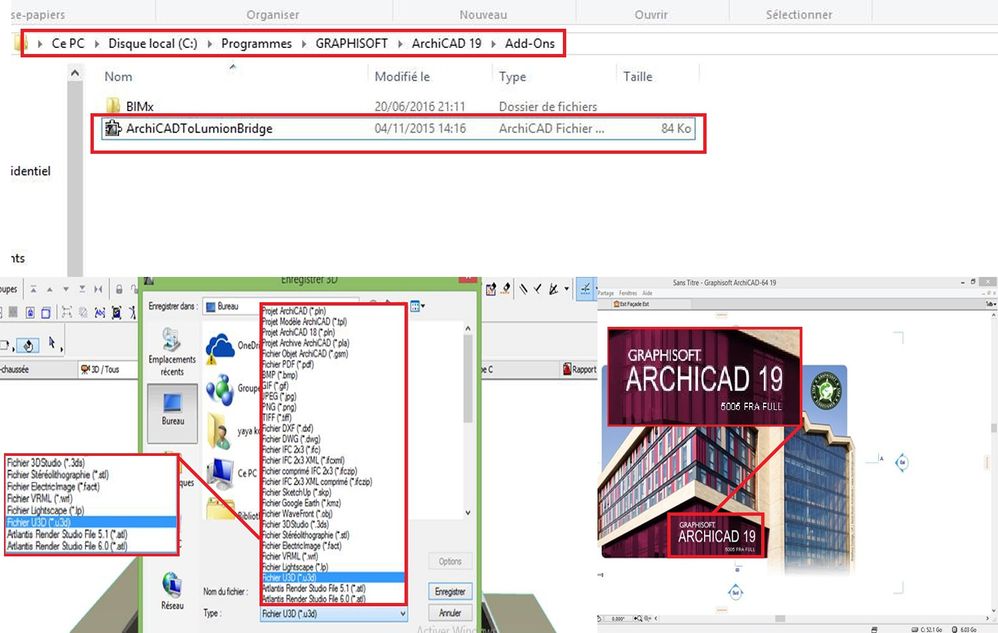

I am having trouble exporting from ARCHICAD to LUMION
could you help me please ?
ARCHICAD owned (v19 Fra) and I updated it to build 5005
I've downloaded the export LUMION add-one from the official website of the software program
and I added it to ADD-ONS folder, as shown in the picture below, but the problem persists
I did not find a Format (.dae) to export LUMION program within the list of export formats.....

Thank you my friend to answer , but the problem lies in the ADD ONS
I did not find it in the" add-on manager"
maybe this shows it is not affixed to the folder add-ons in the program folder !
I am installed it and already copied to the folder "add-ons", as in the picture!
thanks !

Dissolved the problem and the solution was the way .. as follows :
delete Archicad with all folders
Re- install the program Archicad 19
Download the latest version of the update ( 5005 ) with activation
Copies add to the export program lumion to the next track
C: \ Program Files \ GRAPHISOFT \ ArchiCAD 19 \ Add-Ons
.. Then immediately with the additive appeared in the list
In the event it did not appear .. need to be reviewed : add-on manger: to make sure activated.
