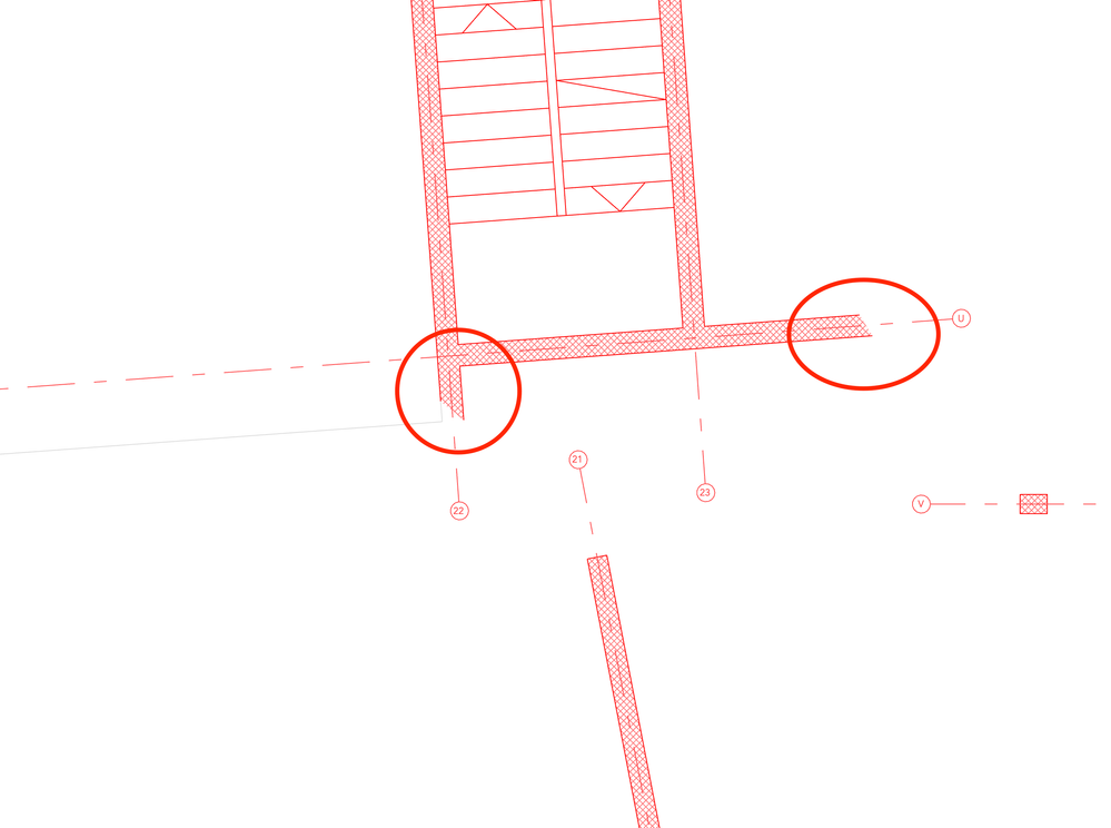

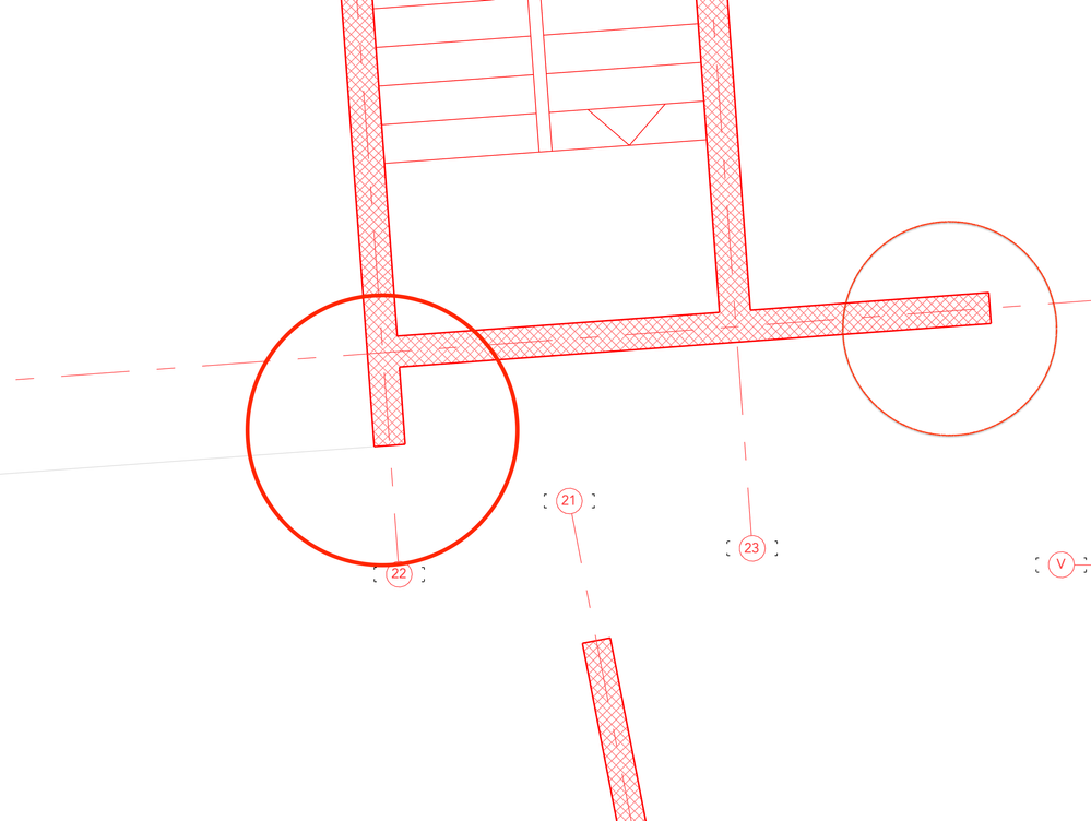

Hi!
I'm modeling a project and I run into a small issue: Im trying to export a plan showing only the load bearing cores. As Im working in plan everything displays as desired, however, once I place it on a layout, some wall ends behave differently, and I do not understand if there is something I might be doing wrong, or if its just a bug in the software. For more information I attach two images, one with the desired walls in plan view, and the glitched version of the same plan placed in the layout.
Thank you for your time and interest!
Kind regards,
Armando
iMac late 2014, macOS Big Sur, 32 GB ram, Archicad 23
Capture d’écran 2024-12-09 à 10.29.31.pngCapture d’écran 2024-12-09 à 10.30.59.png

Check if the layercombination of the view on the layout is the same as the view you are working on.
The walls seam to connect with walls that are not visible in this plan.  You can dot this by turning on all layers on and looking in the 3d model for
connecting walls.

Hello cuba, I have the exact same view settings in both cases (layer combination, renovation status, graphic overrides, scale, etc...) that is why I don't understand where the mistake could be
cuba
Did you use the renovation pallet?  Sometimes some elements (like stairs) are not visible due to display settings of the renovation tool....
