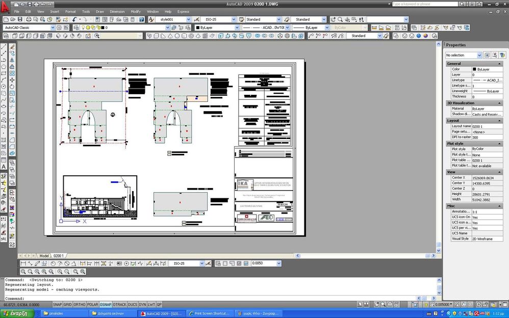

I have a question on exporting AC layout to dwg files.
I have set up a translator to export the layout to Paper Space With Cropped Drawing Content on DWG. I also use a template file.
The problem is that when i open the DWG on Autocad, i have the viewports on the Paper Space that are not "locked" i.e. if you accidentaly scroll the mouse wheel you lose the correct zooming.
See the attaced image.
How can i get to have the viewports locked???

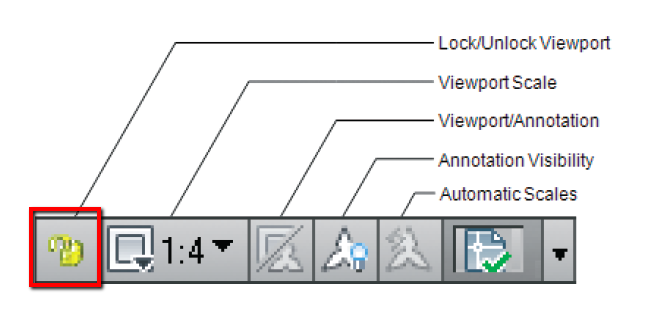

Although I didn't see this happening with my AutoCAD 2006 for the drawings I export from ArchiCAD, I guess in AutoCAD 2009 you can select the viewport and click on the Lock/Unlock Viewport button.
Also this lisp can help
(Defun c:VL () (COMMAND ".MVIEW" "L" "ON" "ALL" "") (PRINC))
Hope this helps.
