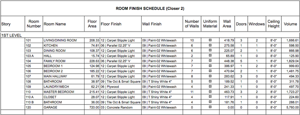

I have been working at this for 2 days trying to create a roof finish schedule. I'm not remotely close to something that may work and it's so vastly different from anything I used to create without a BIM application (2d). Granted, I'm new at this but it can't be that difficult... What I've created seems like smoke and mirrors and it's only partially interactive.
Below is the so-called room schedule. This is not a Zone List as I believe I should be trying to use. I've not been able to modify any zone list much less be able to read them without really zooming in.
How do I link wall finishes (NSEW) to the zone settings? Basically, I don't have a clue. Where can I start to learn how to make a room schedule that notes: floor substrate/finish, base substrate/finish, wall substrate/finish (NSEW walls), ceiling substrate/finish/height, and remarks?
The last thing I want to do is create a schedule from my own computer-mind. I can see the information, I just can't extract it from AC...

Is the schedule you show different from what you want it to look like? If so, post a shot of what you used to do.
Also, post a shot of the settings for your schedule.

Attached is the Scheme Settings that I've been able to modify but it's all fakery. The schedule shown above is not what I want indicated. In the past I note the following: FLOOR substrate/finish, BASE substrate/finish, WALL substrate/finish for NESW walls, CEILING substrate/finish/height. Then I attach specifications regarding finish materials and execution.
