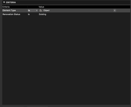

Team:
I aim to create interior elevations where all new elements are displayed with their design finish, while existing elements are not. This could not be achieved using the Renovation Status. However, I found a solution using a simple overwrite.
The new overwrite has two simple criteria, please see the attachments for details.

iggiv
Max,
Thank you again for your comments. I wanted to edit my comments to clean them up but wasn’t sure how to delete or edit posts. As you can see, one of my comments was sent twice. I deleted the comment but couldn’t delete the post.
To clarify, I found the problem, and it was resolved once I restarted the computer. I managed to make it work as per my last comment.
I will accept as solve this ticket to avoid more confusion. Thank you again for trying to help.
