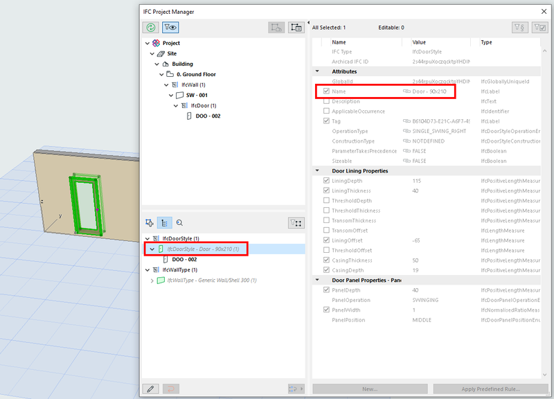

Try to map the desired values to the "Name" IFC Property of the IFC Type under IfcTypeProduct under the IFC Scheme hierarchy.
In the below example, I did a mapping for Doors. I created a mapping to the "Name" IFC Property of IfcDoorStyle. The value will be the library part name of the Door, followed by " - " characters, followed by the value of a Property returning the width by height value of the Door in centimeters ("90x210" for example).

If you did it well, you will see the result in the IFC Project Manager:

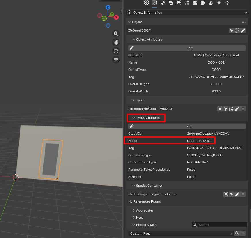

Also, here is when I opened the exported IFC file in Blender and checked its Properties:

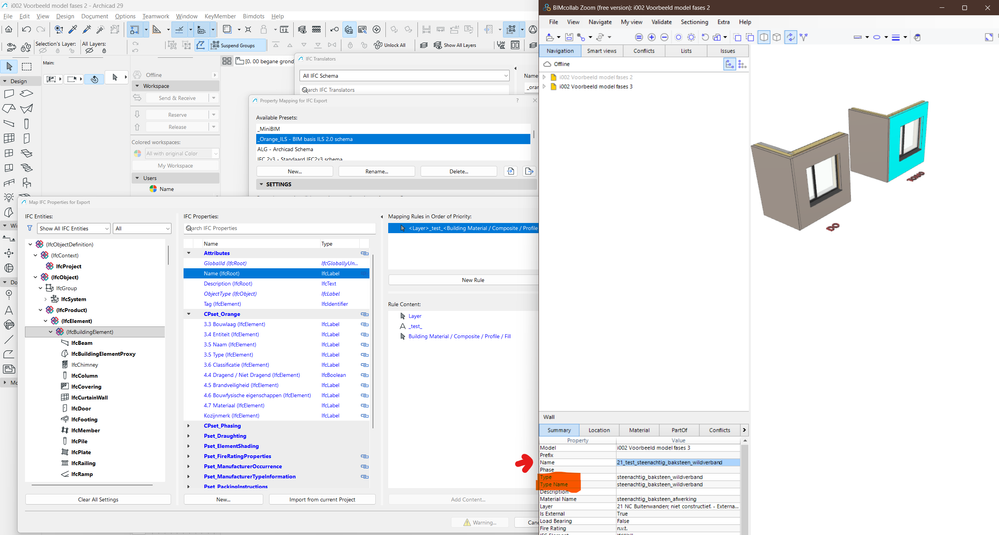

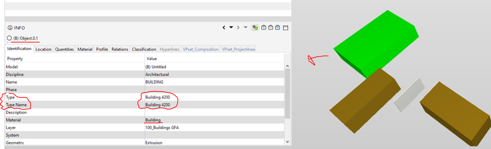

Unfortunately the name property gets mapped to IFC name. I'm looking on how to modify the "Type" and "Type name" fields.

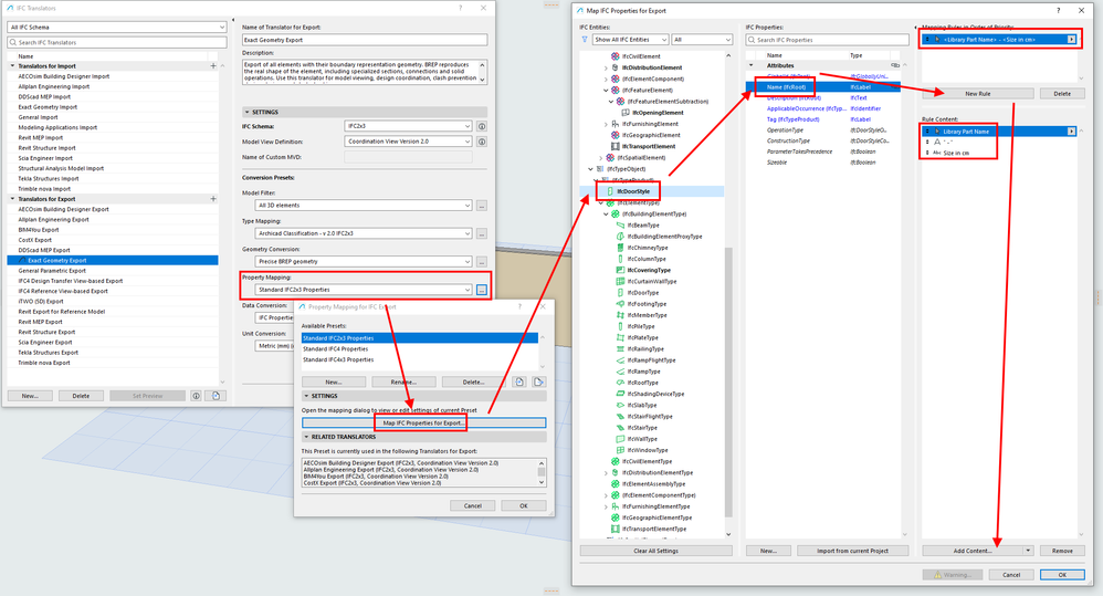

You did it in the wrong place. See my first screenshot. On the hierarchy on the left, find the items with the green icons before their name (everything under IfcTypeObject), not the black ones (which are under IfcObject).

In the meanwhile I managed to find that the Type gets the value of the Reference property in the *.Common pset. and I set it from there from the black icons.
The inner mechanics of mapping the properties to what gets seen in an IFC viewer are a bit unclear for me.
