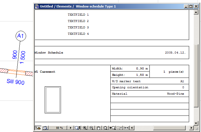

Can somebody help me, when I use ā€œList Elementsā€ Window schedule Type 1, in listing I would like to get Marker text instead of User ID. Basically can I edit element lists, and how.

OK, here is how to do it.
Step 1:
In the List Setup Schemes Dialog, uncheck User ID parameter from the Global Element Parameters list, and check the W/D marker Text parameter in the Extra Parameters of the Selected Types list.
Step 2:
In the List Format Tab Page, move the W/D Marker Text item to the 4th position (where the User ID was before). This will enable it to be listed in the same position.
Click OK in the Dialog to close it.
Step 3:
Regenerate you list.
It should display your desired value.
Of course, make you you set your Maker correctly in the Door/Window Settings Dialog so it has value to be displayed.

Thank you Laszlo, it’s working, you are a real friend.
