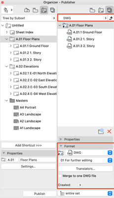

The best is to create a dedicated Publisher Set and use the Organizer to set all the layouts you want to save in DWG within that Publisher Set (on the left side of the Organizer choose Layout Book, on the right choose the new Publisher Set you've created, select layouts from the left you want to add to the publisher set on the right, or drag and drop them). In the Publisher Set properties you can set the publishing location and within the set you can choose DWG format. Check these
