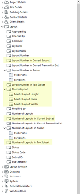

Seems like AC 26 has this feature, I just looked at the video on youtube:
https://youtu.be/1Atigka6-wc?t=180
I will have to wait for our local version to be downloaded, but i hope/think this was spot on!
regards
David G
ArchiCad since 8.1
Mac Studio (2022) - Apple M1 Ultra
macOS Monterey 12.4
Yes, it does, there are seven new Layout and Master Layout-related Autotexts in Archicad 26:
  • Master Layout Height
  • Master Layout Name
  • Master Layout Width
  • Layout Number in Current Subset
  • Layout Number in Top Subset
  • Number of Layouts in Current Subset
  • Number of Layouts in Top Subset
