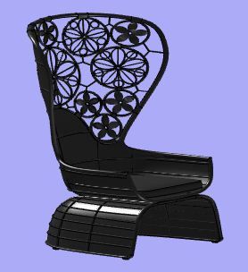

When converting the 3ds to gsm, I have lwft the box 'Import Hidden Obects' & 'Use texture's alpha channel' ticked. Once converted, I have left the 'Use objects materials'. The result is black with shades of grey whereas ths original is wicker coloured.
Any ideas?
Thanks.
