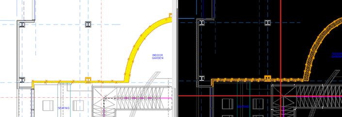

Currently if a custom shaped linetype is exported to AutoCAD, ARCHICAD will create a linetype that has all the segments of the linetype in one shape definition. The disadvantage of this is first that in case of polylines AutoCAD will display the shape in a kind of unpredictable starting position, the second is that if the polyline or line segment is shorter than one segment of the special shape, then it will not display anything even if one or more arcs of the shape would fit into that segment.
By default

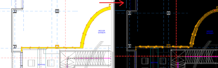

With matched AutoCAD linetypes

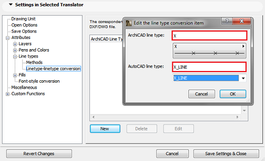

Step 3. Set Linetype-conversion option in ARCHICAD
  • wp-content_uploads_archicadwiki_dwg-export-customlinetype--007_linetypeconversion.png
  • Open DXF-DWG Translation Setup dialog in ARCHICAD.
  • Load the saved DWG as Template File under Save Options. It contains all Attributes information which ease you to set the conversion options.
  • And under Attributes/ Line types/ Linetype-linetype conversion match ARCHICAD and AutoCAD line types.
  • Save Translator Settings and Close the dialog
  • Save your ARCHICAD project to DWG. ARCHICAD's linetypes will appear with the matched line style in AutoCAD.
