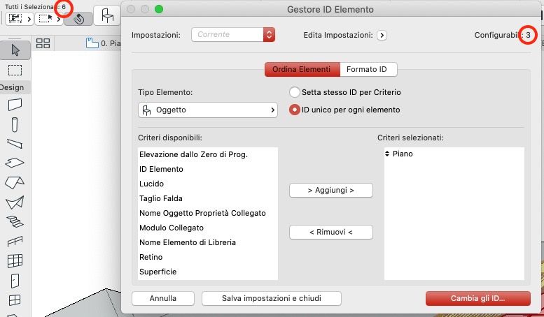

I'm trying to assign new ID in comparative view (all rehab elements on): although I've selected all rehab element type, the new ones are not 'configurable'.
I've checked in a new file but it works, so the problem is not the Archicad general setup and installation.
Is it possibile to find the problem?

I've tried more options:
  1. passing by a view with rehab filter showing all items (to be demolish, existing and new), no overrides;
  2. passing by a view with rehab filter showing new and existing items, no overrides, and not showing to be demolish items.
It seems I solved the problem with the second option, don't ask me why.

Hi @claudio_pia, in these cases I find those items selected but not editable are in a hidden or locked layer, hope it helps.

Thank you Mahmoud: I've checked yet. All items are in visible and unlocked layers.
The problem is transversal: objects, walls, etc..

@claudio_pia , I won’t ask you why but every day I realize that Archicad elements has 3 mysterious areas you should take care or you will be lost : 1 ) Layer Compos..... 2 ) MVO..... 3 ) Renovation Filters.
