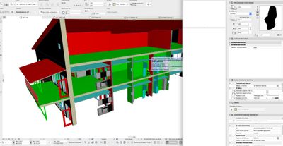

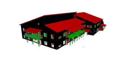

Hi, I got IFC model from AutoCad 3D and I have to do some changes in the model.
Is there some way how can I replace or convert modell to Archicads design tools ?
- For example change all toilets to all toilets from Archicad library objects ?
- Or change all walls, slabs, windows and doors to AC
It would be helpful if it can do this with out to re-modelete all house.

Hello Vojtech Slavik,
The IFC format can be exported for modification but no software certfiication will guarantee the result. To do this, it is necessary to export the IFC format with an MVD of type DTW (Model View Definition: Design Transfer View). Archicad is able to import an IFC of this type to allow editing, but Autodesk Autocad does not have any certification in this regard. To know the type of MVD of your IFC : read the IFC file in a text editor.
If your IFC file is a Reference View or a Coordination view export, you will not be able to modify it as you want.
Finally, think about the import parameters of your IFC file because Archicad offers a wide choice of export and import parameters for this format.

Thank you 🙂  I see it's looks like that it will not work for me unfortunately.
I can't change exported IFC file
It's pity that I can't replace or convert to the AC tools.
for me IFC translation is quite hard for understanding. which translator doing.
Anyway thank you 🙂
