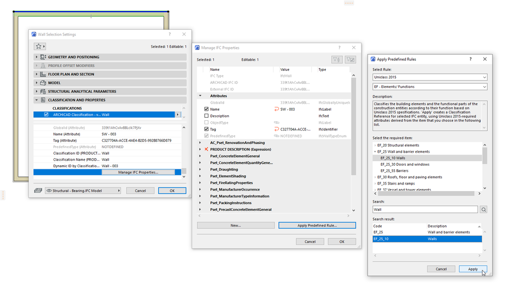

Do you apply the Uniclass Classification Reference as I show it in the below images?
If I do it this way, export it as IFC (make sure Classifications are set to be exported), then import it back into Archicad (make sure Classifications are set to be imported), it will export and import correctly.
