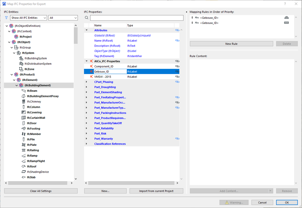

This property has been included in the Property Mapping of the IFC export translator (AC26). Two mapping rules have been created so that the property will be added on the element as well as on the component level.

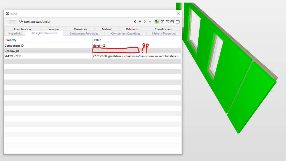

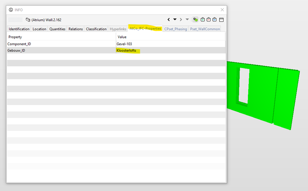

Sadly though, the exported IFC only holds the information on de element level, and not on the component level. This means that for all composites and complex profiles we can not assign volumes of the materials to the specific part of the building.
Strangely this all works well for other properties. Component_ID, which holds the name for each building element, is available at both element en component level. The same goes for the material classification VMSW - 2015.

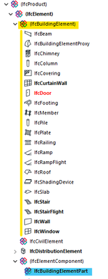

since you put the Gebouw_ID in the ifcBuildingElement it influences everything marked yellow. But in your case for the component you also need to add your custom property to ifcBuildingElementPart (marked blue)

I have added both the element and component option as seperate values (not the "only for components" option).
