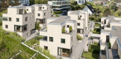

... an issue with Archicad's IFC reader implementation that Graphisoft could easily resolve...
... if all buildings share the same (or a subset of the) storey stack.
Archicad itself doesn't support multiple-buildings-with-different-height-in-one-file-projects, so why should the import?
Imagine an IFC file of these little boxes:
Would be nice if the IFC import would check the buildings for similar storeys and offer "import all" though.
But until then the 'multiple PLN hotlinks, each with a single building IFC hotlink' seems the way to go.
