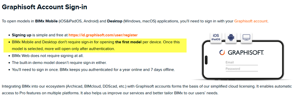

I believe each of your clients will need to creat a Graphisoft ID if they want to view more than just the one initial model you send them.
https://community.graphisoft.com/t5/BIMx/BIMx-Licensing/ta-p/304184.

As far as I know (from reading above), is the client just needs to create a Graphisoft ID which is free to do for anyone.
I am not sure if there are any extra steps where you have to say that a particular GSID can load your BIMx files or if your client simply logging into BIMx with a GSID is sufficient or them to see any files you share with them.
