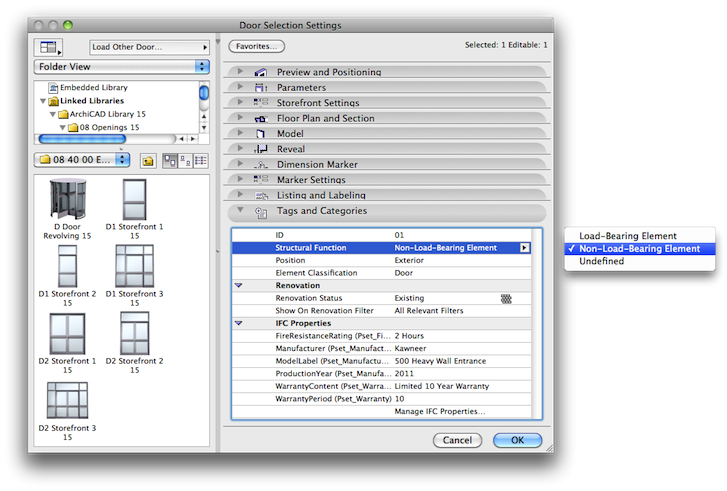

  • Open the selection settings dialogue box for elements to adjust their IFC parameters.
  • Define the Structural Function of the element.
  • Set the Position of the element within your project.
Setting the Structural Function and Position of the element will help the translators to filter out unnecessary data from your project when saving to IFC.
  • Set the IFC Classification of your element.

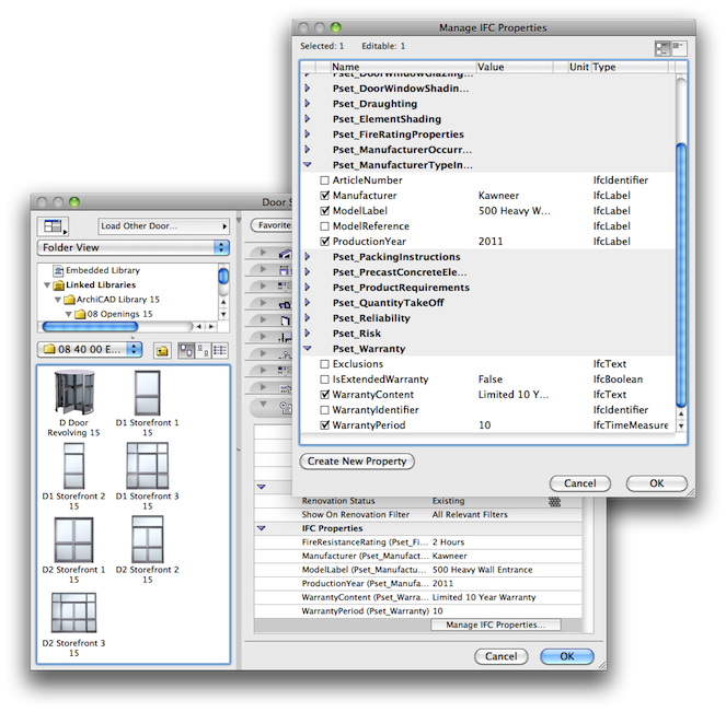

  • Enable the necessary IFC properties for the element.
Setting the Element Classification (or IFC classification) and IFC Properties of an element ensures that it and all corresponding data will be included in your IFC.

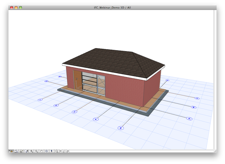

  • Create a layer combination from the step above.
  • Save a 3D view of your project that uses the previously created layer combination.
    • This will allow you to easily switch to a view from which you can save your IFC.

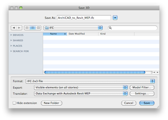

3) Export an IFC for Revit MEP

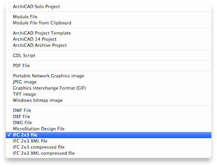

  • From the 3D view you just created, go to File/Save As.
  • Change the Format to IFC 2x3 file.
  • For Export, select Visible elements (on all stories).
  • Select Data Exchange with Autodesk Revit MEP for the Translator.
  • Save the file.

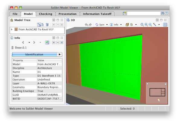

4) Verifying IFC Integrity
Before sending your IFC file to a consultant it is recommended that you double check it in an IFC viewer. Links to several free IFC viewers can be found here.
  • Check to see that the geometry within your file is correctly represented.
  • Select an element to verify that it has been classified correctly and that it includes your custom properties.

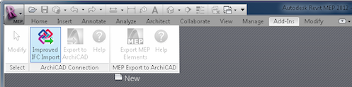

5) Open in Revit MEP
Prior to opening the IFC, make sure that the Revit MEP user has downloaded and installed Graphisoft's Improved ARCHICAD Connection Add-in located here.
  • Open Revit MEP and under the Add-ins tab, click the Improved IFC Exchange button.
  • Select the IFC file and open it.

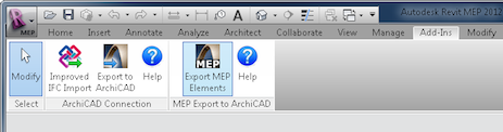

6) Export an IFC from Revit MEP
This step demonstrates how your consultant can export only the MEP data from Revit to an IFC. If you or the consultant require the entire contents of the model in IFC then refer to the corresponding step in the Revit Structure exportation process found here.
  • While in the project file, under the Add-ins tab, click the Export MEP Elements button.
    • This option will only export the MEP data convert it into ARCHICAD MEP objects that can be used for collision detection.
  • Save the IFC file.

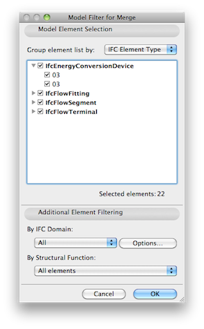

  • In the Model Filter for Merge dialogue box make sure that all elements listed are checked.
  • In the Additional Element Filtering tab make sure that By IFC Domain is set to All and that By Structural Function is set to All elements.
    • By using the Export MEP Elements function in Revit, all unnecessary IFC data has already been purged from the file. In cases where the add-in isn't used, you can set the options above to limit which data is imported.

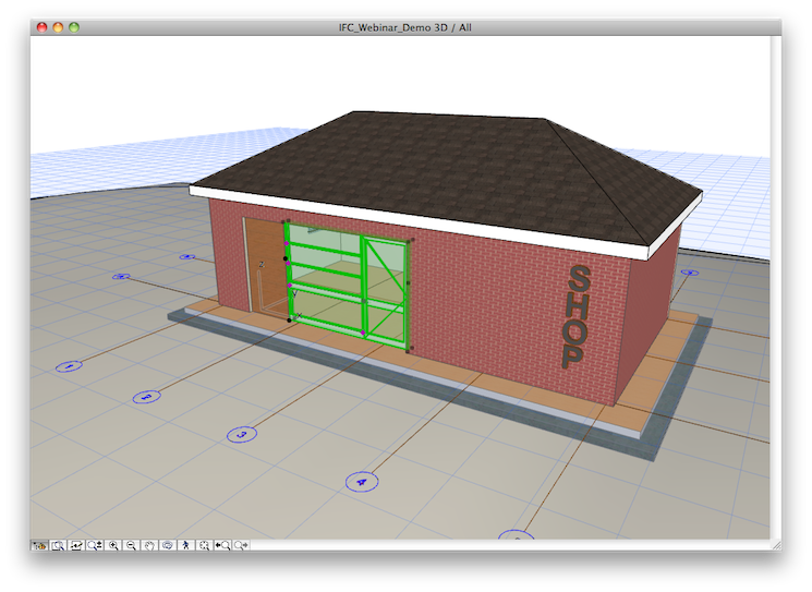

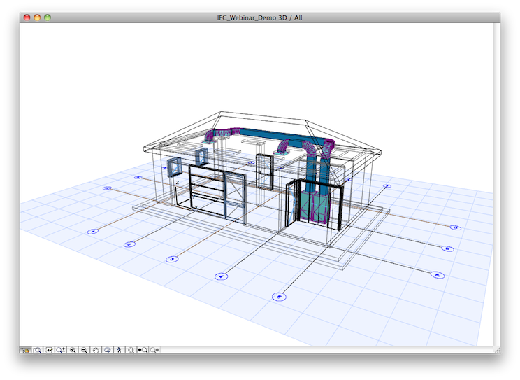

  • Navigate to your 3D window to verify that the IFC elements have imported properly
  • Select one of the imported IFC elements and open the settings to verify that it has been converted into an MEP component.
