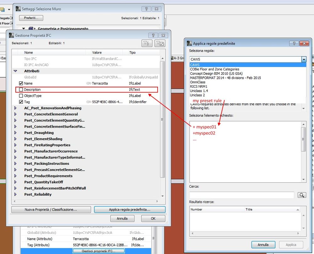

I'd like to define a new preset IFC rule creating new IFC properties and filling it with some preset data.
I saw some coding into the preset IFC rules defined in AC out of the box but I didn't find a "simple & readable" example of xml coding for new IFC properties.
For example I'd like to fill the field IFC "description" with a text using a custom made db properly coded as per IFC syntax
Is it possible?
Where can I find documentation on the IFC syntax and coding?
Thanks for any support
