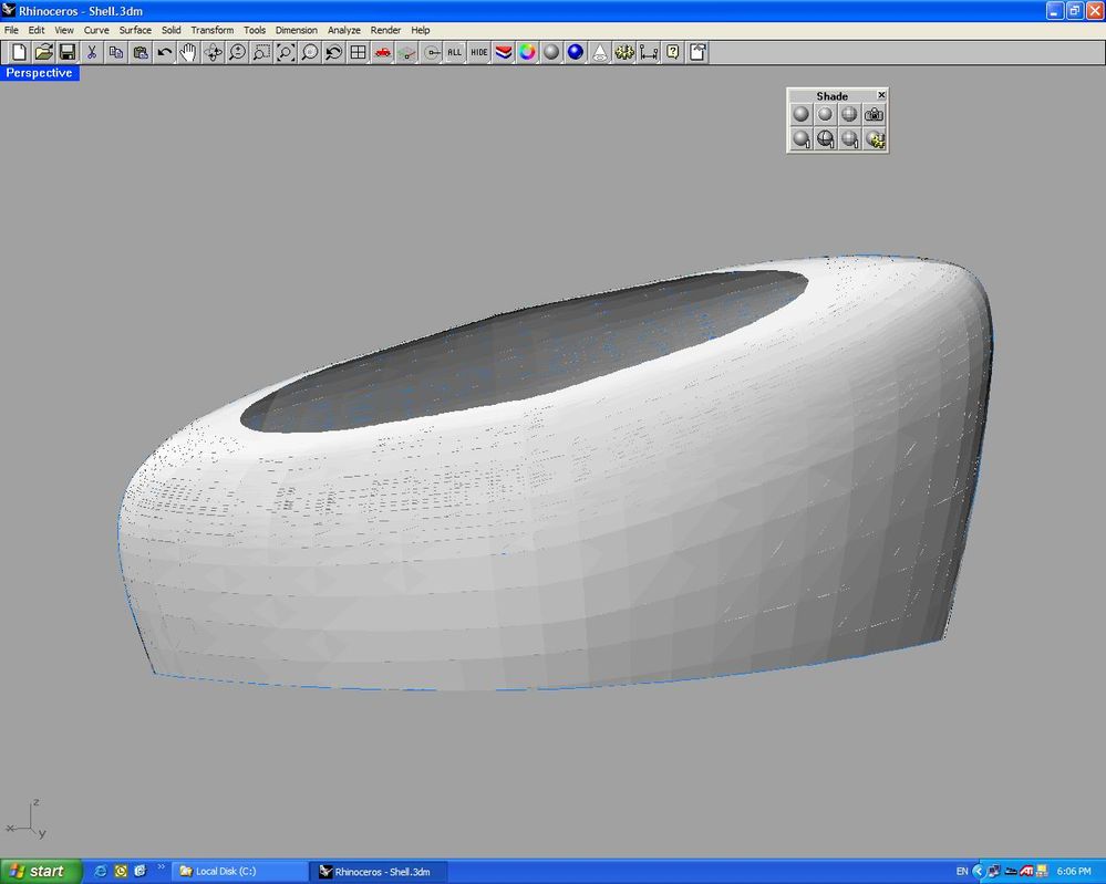

Import from Rhino?
If we agree that shells like this can not be modeled by ArchiCAD, and let's say it is Rhino or any other modeling software, what is BEST procedure for 3D model import to ArchiCAD?
I must say that DXF files are extremely big and ArchiCAD usually crashes.

Thanks Dave, but don't think that "quantum leap" reaches NURBS modeling that I need for this kind of model? Usually you start from basic shapes like flat, sphere or cubic surfaces and you interactively edit them. It is advanced modeling, like sculpting.

ArchiCAD 7.0 - Rhino
I use for communication format .Obj (Wavefront) in ArchiCADu. It is possible create only binary , but be able to very pretty remove edge. Loss do you new 8.1 obj arrest no-supports ((. Rhino is elite additional modeller for ArchiCAD .
I know about .obj, OK it's for 7.0.
Any suggestions for 8.1? Any suggestions for surface smoothing?
DXF model importing is the only way and I can't get smoothing.
I wonder if Cinema 4D and other advanced modeling software users has overcome this problem.
