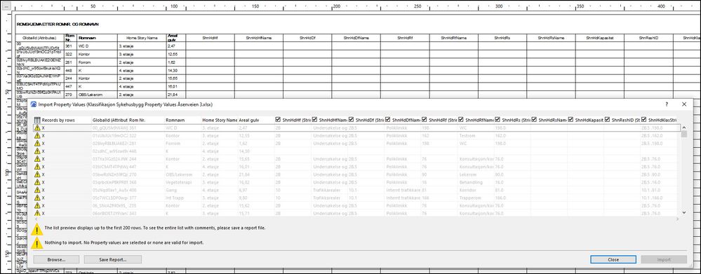

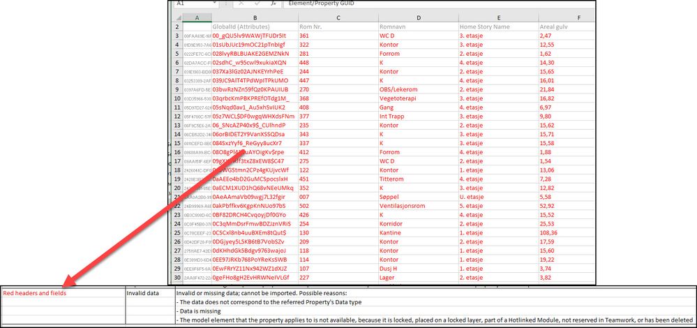

But I do have a new one that arose yesterday. It is the same schedule, but another project: I export scedule, do my thing, and want to import it again. I've done this a 100 times without any issues, using the same template every time,  Yesterday, However, Archicad wouldn't import. See attached images, one is from actual import, the second one is a snag of a part of the log... If it matters, the receiver of this data is all zones...
Imediately I did a dummy test in a fresh project, same tpl. No issues at all.
Which leads me to think that I've accidently did something, like locked the spaces or something...
