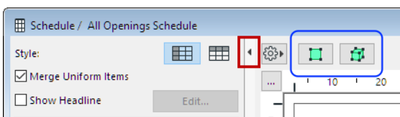

@AndreaTonic Objects in the schedule can be viewed in the model by clicking on the icons I have marked in blue...
Thanks, DGSketcher.
Already tried both and in plan and in 3d is appearing as just one file.

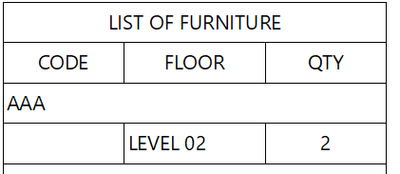

I changed the unique ID of the object to  AAA.
I have created the schedule listing code of elements in relation to the ID and quantity.
I just placed 1 object and this is the result:
sometime if I convert the object in morph and create the object again works...sometime no.
