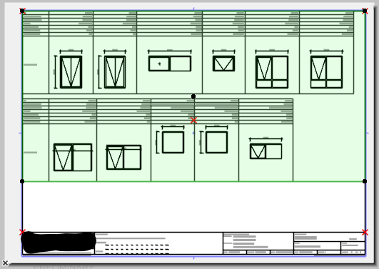

I have a window schedule that is too long to fit all horizontally on the sheet. How can I get multiple rows for the window schedule so it isn't all one line?

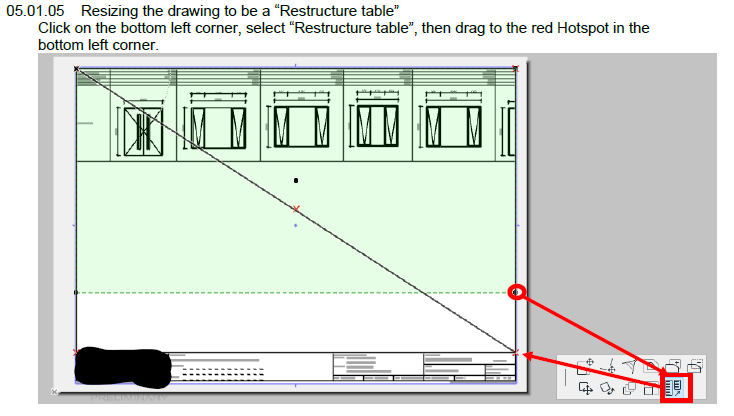

From Archicad 26 onwards, if you have already Cropped/Resized the frame you will need to go into the
Drawing Settings -> Frame -> Fit Drawing to Frame
then "Restructure table" will appear in the pet pellet when you go to edit it.
Sometimes after placing the drawing on the layout,
you will need to Crop or Resize then frame,
then change to "Fit Frame to Drawing" ,
and then the "Restructure table" will appear.
I hope this helps.

You might want to look into: https://help.graphisoft.com/AC/26/INT/_AC26_Help/050_ViewsVB/050_ViewsVB-106.htm

Is this what you are after?

I haven't actually been able to find the restructure table option on the pet pallet (I use ArchiCAD 29).

a month ago
Thank you so much, you saved the day!!
