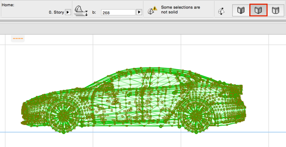

The floor plan view is too detailed, 3D is OK, but elevations are also affected. In general, floor plan views are not truly projected, unlike elevations/sections, but this is special content, so we see the same level of detail. If you want to clean up the elevation as well it’s best to start with that part, if not you can skip to step 3. To fix the side views we need to change the level of detail of the 3D.
1., Select the object and use Convert Selection to Morph(s) from the context-menu and change its edge settings to Hidden – triangulation gone!

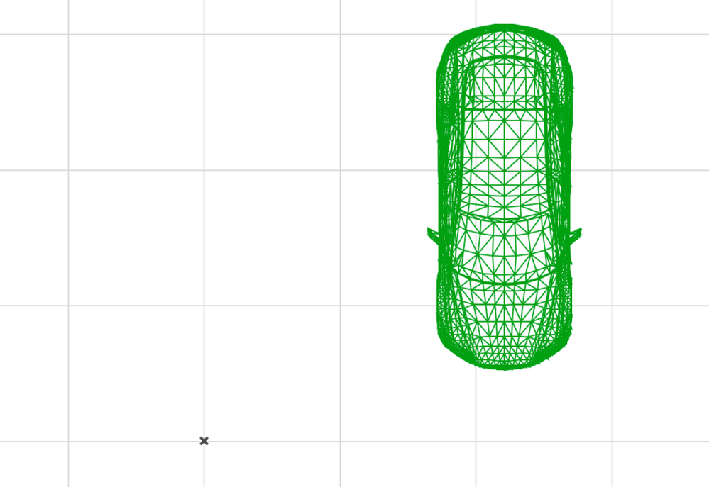

2., The floor plan representation of the Morph is quite different then earlier but still needs cleaning. Let’s save the Morph back to an Object and tweak those GDL settings!

4., We will draw the symbol ourselves, even better: copy the actual floor plan view since it is almost good, it is just too detailed. Switch back to the floor plan on the Tab Bar and right-click, then Copy on the selected element.
5., Switch back to the GDL Editor and go to 2D Symbol, right-click and Paste. Make sure you paste the content to the original location, in case you are zooming in too much. Now the 2D View is generated from 2D elements, not a script and this way it is editable!
6., Clean up the 2D by selecting and deleting the unnecessary lines. This might take some time depending on the quality of the model. You can also define new anchor points of the object by using the Hotspot tool or even add new drafting elements to be part of the symbol.

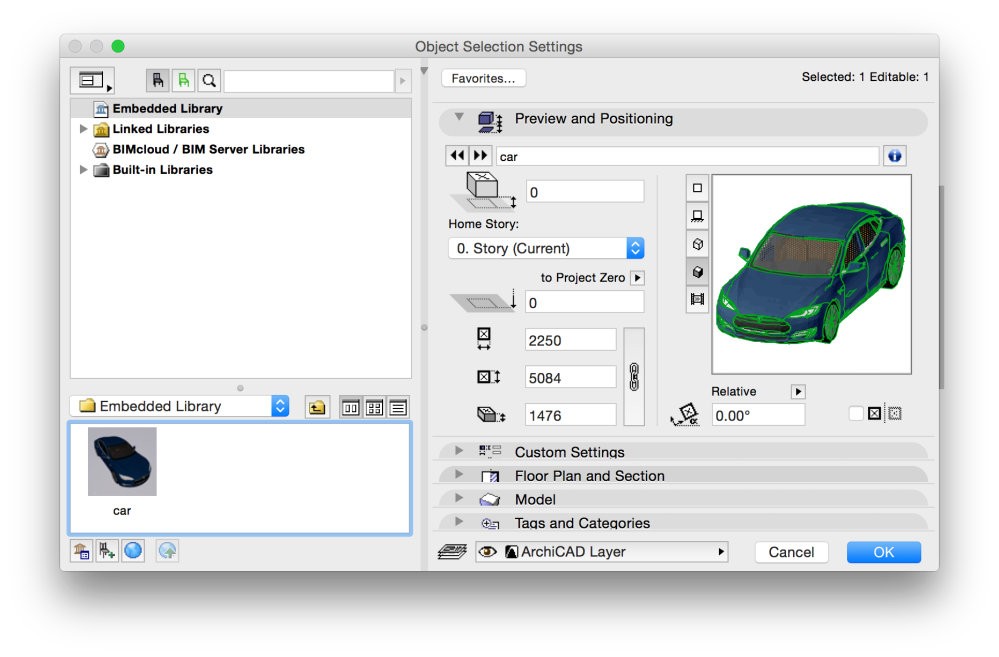

9., Now you can close the tabs of the GDL Editor and save the object, all views/representations will change accordingly.
Opening the Object settings you can check the result – clean 2D and 3D, within minutes.
