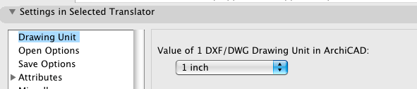

Hi Rick,
There are two scaling things to consider.
The scale that you are using (display scale) needs to match that of the scale of the original dwg for text to come in at the proper size.
The scale problem that you're running into is the mapping of dwg units into ArchiCAD units. That is set up in the dwg translator options. Right now, you've got one dwg unit going to 1" and it needs to change to 1 foot.
Cheers,
Karl

Rick Thompson
Well, thanks for the replies. I am closer, but for the text to look right, the drawing scale needs to be 1'=1' with the translator set to 1' and the "scale factor" set to 1:1.
If I leave the Translator set to 1 foot, and set the "Scale Factor" to 1:50, the scale works, but the text is way big. However, I deleted the text and can now place a pasted foundation on the site to see how it fits. So, still something missing in my understanding that I would like to get, but it is workable now.

Graphisoft Partner
Graphisoft Partner
Karl said it.
Try importing at the scale in which it was drawn, makes sure the units are translating properly (use inches) and leave your scale factor set to 'Always use the scale set in the currently active ArchiCAD window'.
Then you should be able to change your floor plan scale to 1:50 and have it look right.
Cheers,
Link.
Thomas Holm
Rick, you've got to set the drawing unit right, or all dimensions will be off.
When that is done, you can experiment with the scale setting before your import to get the text size right. I tend to do that, then I select all text and change it from "fixed" to "scaled" so I can change the scale to what I want to work with without the text size screwed up.
And remember, all translator settings work only when you Merge or Xref the dwg file.
Rick Thompson
Got it... thanks
Translator set to 1 foot, use scale in active window (1:50 here) and opening at 1 foot.
