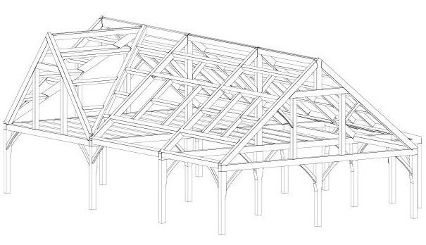

BTW, what are the shapes you are getting into ArchiCAD? Screenshot? Rendering? Let us know
Tried to post multiple attachments, but could only attach one. Is it possible to post an image into the reply other than as an attachment? Was trying to show the overall timber frame model and a couple of individual timbers from that model with their joinery.
The formZ model will be made up of 200 to 300 individual timbers. Some, such as knee braces, floor joists or roof purlins may each be multiples of one timber. Each timber is an individual object in formZ. Certain timbers are put on specific layers. Groups can be created within both the layer dialog and the object dialog. Groups can be used like the stories in ArchiCAD and you can hide or ghost individual objects, layrs, or groups of either. Makes it a lot easier in developing the entire model. One only needs to see and work with the relevant timbers of the model.
Here is an entire formZ model of a timber frame.
