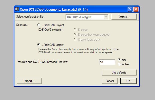

Petros, got a problem.
O.k. I made a sphere in Rhino. Radius 10 centimeters, used one layer. Export from Rhino using dxf. format (picture). Opened ArchiCAD (Version 7, maybe thats the problem, but doubt it) closed all projects, then went File-Open file type Dxf,Dwg (picture). Now since sphere in Rhino was modeled in cm, 1 cm=10 mm, I clicked ok. then I got message picture3.
What did I do wrong?
I attached the dxf. file also
