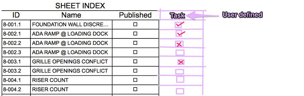

Yes, Published and Issue Schedules have a box, that when the operation has been preformed the SYSTEM / PROGRAM SUB_ROUTINE automatically checks of the box.
One is looking to have this same interactivity, based on user definitions, for instance marking a particular table / schedule of an item that wants to be checked off / X'ed out. See screenshot.
My review of documentation has produced nothing.
Perhaps this clarifies the intent of the request.

I think you will not be able to get a checkbox on Sheet Indexes, because
1. It is not possible to add custom Layout parameters to projects.
2. Even if it was possible, these custom parameters are usually text parameters, not boolean (True-False, like a checkbox) parameters.
