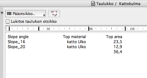

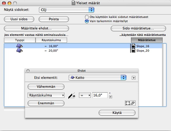

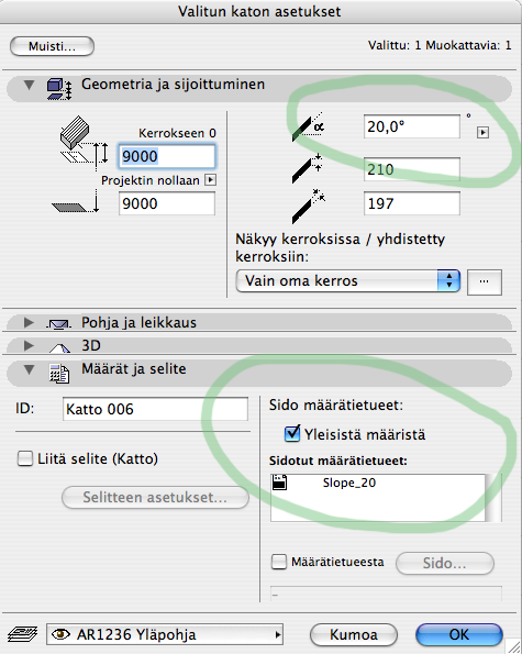

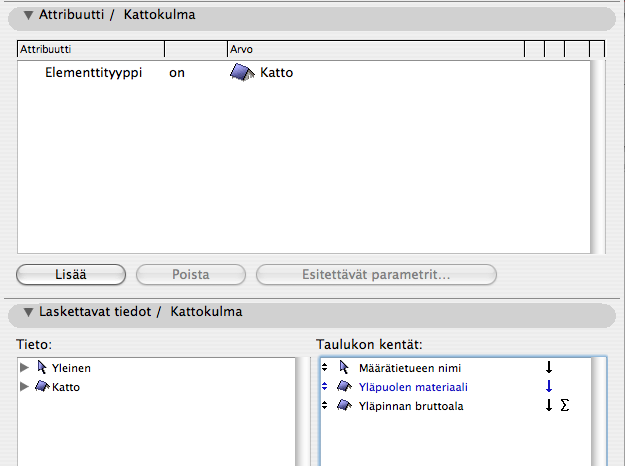

Hello,
With linking property objects to the certain pitch angles the roofs can be differentiated.
1] Choose the 'Link Properties to Criteria' command and make one new criteria / pitch angle. You have to make new 'dummy' property objects to your library (here 'Slope_16' and 'Slope_20' respectively).
2] ...so the property objects are linked automatically by pitch angle...
3] ...and the property objects can be picked in the schedules.
Here the column 'Slope angle' is showing the linked property object.
Sorry for finnish localization- hope this helps!
