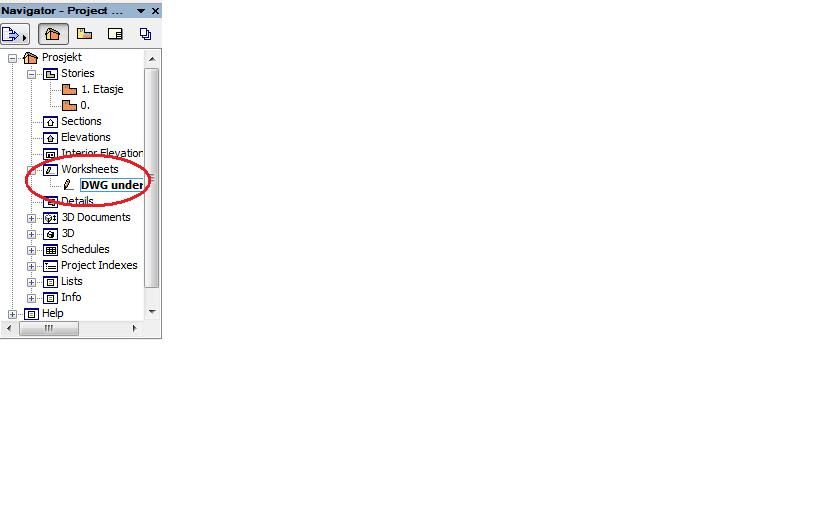

Excuse my limited understanding of the word "surveyor". Do you mean landscape mapping (in Norwegian Situation Map) e.g. a map of for example 1:1000 that you place your Floor Plan on? If so: What about using the Worksheet Tool to do the transfer of the DWG File to ArchiCAD?
Set the Worksheet active in Navigator.
Use File - External Content - Place External Drawing.
Select the drawing by using the Arrow Tool and Ctrl+A and then Explode into Current View. Choose Keep Drawing Primitives only. This so the linetypes and text from the DWG-file may be open to change.
Then you have the DWG "under" your house and are ready to work...
