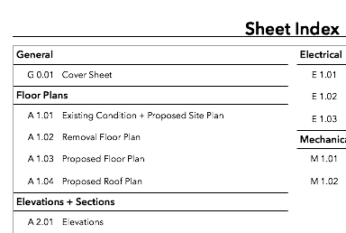

SO.....here's the look I'm trying to achieve.
I simply did this by copying, moving down and splitting up the index into three views.....top = title and description only, discipline headings (done with text only) and the body of the index (coming from the index itself) but how do I format the entire index to produce "THIS" result?

Eduardo Rolon
I don't have the headers on mine but this one is not that difficult to achieve.

Eduardo Rolon
Made a mistake, what I use to separate the Indexes is not Master Layouts but Subsets.

rob2218
So.....are the "subsets" shown automatically in the index? if so..how?
I have my subsets in my index criteria....but they don't display.

Eduardo Rolon
Did you add them to the Index Fields?

rob2218
I did.....and this is what I get?
dunno what I'm doing wrong.
can't seem to figure just "HOW" to make the subset titles appear only ONCE as per my graphics...

rob2218
here's how I'd like it to look like...
