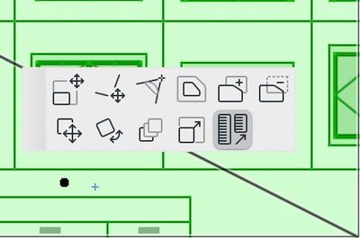

See attached screenshot - Archicad used to enable to "split" bigger schedules into rows to fit in the layout. Now this functionality is gone.
Can anyone point me to a solution here please?

The option disappears if the frame is set to "Crop Frame to Drawing". It should reappear if you change that to Fit Frame to Drawing or Manual Resize.

I just opened a legacy project in AC25 to test this... and my wrapped schedule strangely showed up on the layout as unwrapped.  But, the wrapping option did show up in the pet palette and worked fine to wrap it back to how it was supposed to be.   Are you clicking on the bottom right hotspot?
AC 29 USA and earlier   •   hardware key   •   macOS Sequoia 15.7.2 MacBook Pro M2 Max 12CPU/30GPU cores, 32GB
That may be because those schedules do actually fit on your page.
I can't tell from your image but it looks to me as if the schedules will fit.
I am pretty sure the split option is only available when the schedule is longer/wider than your page.

I think the OP is talking about adjusting the frame, rather than "splitting" it to multiple sheets, Barry (although that was the word used to describe the issue).

Yes! Solved. Thank you, I never knew about these options. I'll update the first post so that people have no trouble finding the solution. Thanks a lot!
