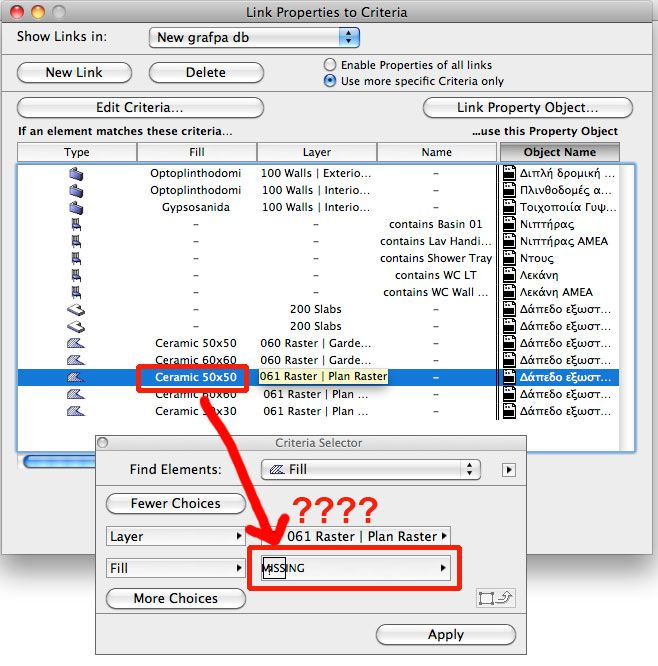

I have a set of Criteria set with AC 13, now that I open an AC 14 file, for some reason i do not see all of the Criteria, but only some of them... Why? Is there a way to import criteria?
Where are criteria saved? Individually in the file, or centrally at the library?

i have 1 addon loaded in both instances, and it's the same (ArchiStair2), but the same thing happens... i still miss some links in the AC14 file...
One other strange thing that i noticed today is that even though on the window (which by the way it can't STILL be resized... http://archicad-talk.graphisoft.com/viewtopic.php?t=32398 ) the criteria appear correct, when i click on the "Edit Criteria..." button for some links, i get a "?" missing... (see attached image)
I think there should be an answer from GS about this erratic behavior...
