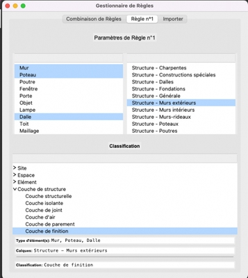

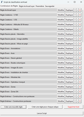

I just have finished a beta version of a python script that helps changing element classifications in archicad based on rules. At the moment, the rules are only layers/element type.
The script is in french, I plan to share it here once translated in english as soon as possible.
Archicad 27 - GDL - PYTHON
