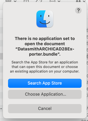

There is no application set to open the document "DatasmithARCHICAD28/Exporter.bundle"
Amanda S
I am new to the TM world. I have AC28. I have downloaded Twinmotion and the Download plug in for Mac. When I open the DataSmith download the dialog box says: There is no application set to open the document "DatasmithARCHICAD28/Exporter.bundle" whereas the video says it should open an installer... help as I don't know what to do next to get AC & TM to talk to each other. Thank you!

You place that file in "Applications › GRAPHISOFT › Archicad 28 US > Add-Ons" and after restarting AC you can turn on the Add-On under Options ->Add-On Manager...
