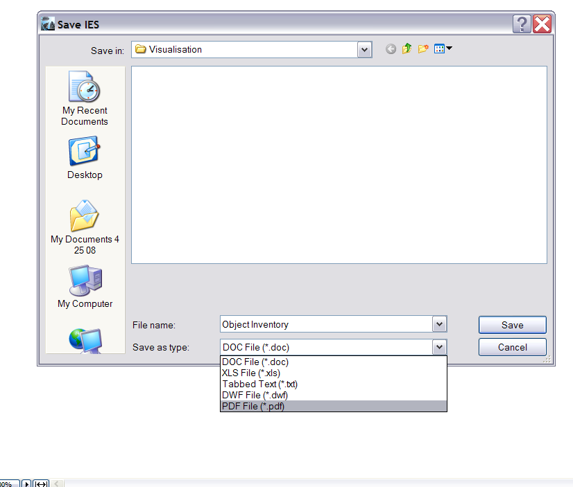

"Saving from a Schedule Window (Interactive Schedule)
Schedules can be saved in the following formats: Tabbed text, DWF, and PDF. From a PC, with MS Office, you can also save in .doc and .xls formats."
How?

When you're in the schedule window, go to File>Save As, and you will see a variety of formats. XML is not one of them.

I was trying to click on File > Save As, but nothing happens when I do that.
The screen blinks just a little like it was going to open the Save As window but nothing happens. I have checked to see if the save window is open somewhere I can't see it but its just not there.
I will try a fresh file. This is an older Beta file saved as a 12 2156 .pln
Steve Jepson
There it is. It must have been the file I was using.
Steve Jepson
It worked one time. Just after I saved the screen shot above I tried it again and the Save EIS screen will not come up again.

The name of the Schedule was 8" Foundation Walls.
The " was the problem.
It should have a pop up that says the file name is not valid.
