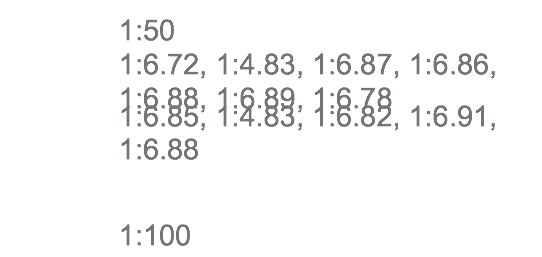

I am making several sheets that have external PDF files on them. When I place the PDFs via File>External Content>Place External Drawing they come in fine, but they have an arbitrary "scale" to them like 1:74.6 (just an example). Obviously when this PDF is something like a spreadsheet or something that isn't actually a drawing, it doesn't need this scale. This isn't a problem except when I make a drawing list for our cover sheets which lists all the sheets and the scales of drawings on those sheets. Is there a way to make the scale of an external drawing not show up in the drawing index?

Not that I know off. The quick dirty trick is to draw a white fill over the part of the schedule that you don't want to be shown. The other option is to create 2 drawing lists one without the scale (for PDFs, Perspectives, etc) and one with.

Does unchecking this help?
Cheers,
Link.
Cheers,
Link.
YES it did! Thanks, that has been driving me crazy

Great glad it worked. I think it is just new in ArchiCAD 18 if I recall correctly.
