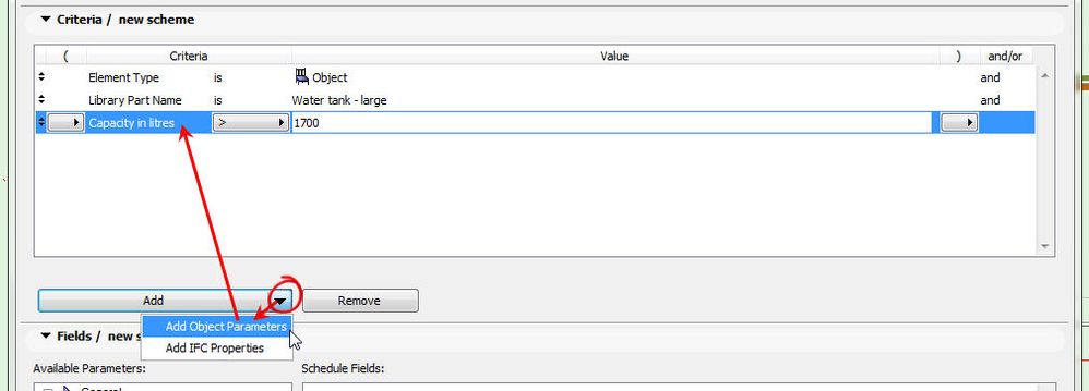

Hi everybody ! I`m newbie on this site and solution might already be founded somewhere , but anyway I would like to ask following question from you guys.
I should need to organize and count some schedule listings by volumes of custom made objects.
For example : attribute might be like-> "only count objects with volume under 1,700 litres" or "only count objects with volume 1,700 litres exactly".
And so on by different values of volume of objects.
Is this possible ? It would be a huge help.
Thank You.
Sorry about my lang.. not my native one!
Reijo
8 REPLIES 8
Sure you can do this but only if your objects have a parameter for the volume.
You just need to add the parameter in your schedule criteria.
See attached image.

Yes your objects will need a parameter for the volume - as My water tank object has in my example.
So if your objects already have this parameter then all is good and you can use that.
If they don't have that parameter then you will need to know a little GDL scripting to add it in.
It could just be adding a VALUE list of available volumes that the user can choose from.
Or you could do some calculation in the Master or Parameter script to determine the volume of your object and then store that as a parameter value that you can then use in your schedule.
How to determine the volume is another matter as that depends on what your object is - i.e. it may not just be length x width x height of the overall object.
You may have to calculate individual components and add them together if for example it is a furniture object or non-cubic object.
So I guess it all comes down to what objects you are using.
If they don't already have a volume parameter are you able to add one or is a bit of GDL scripting out of you depth?
