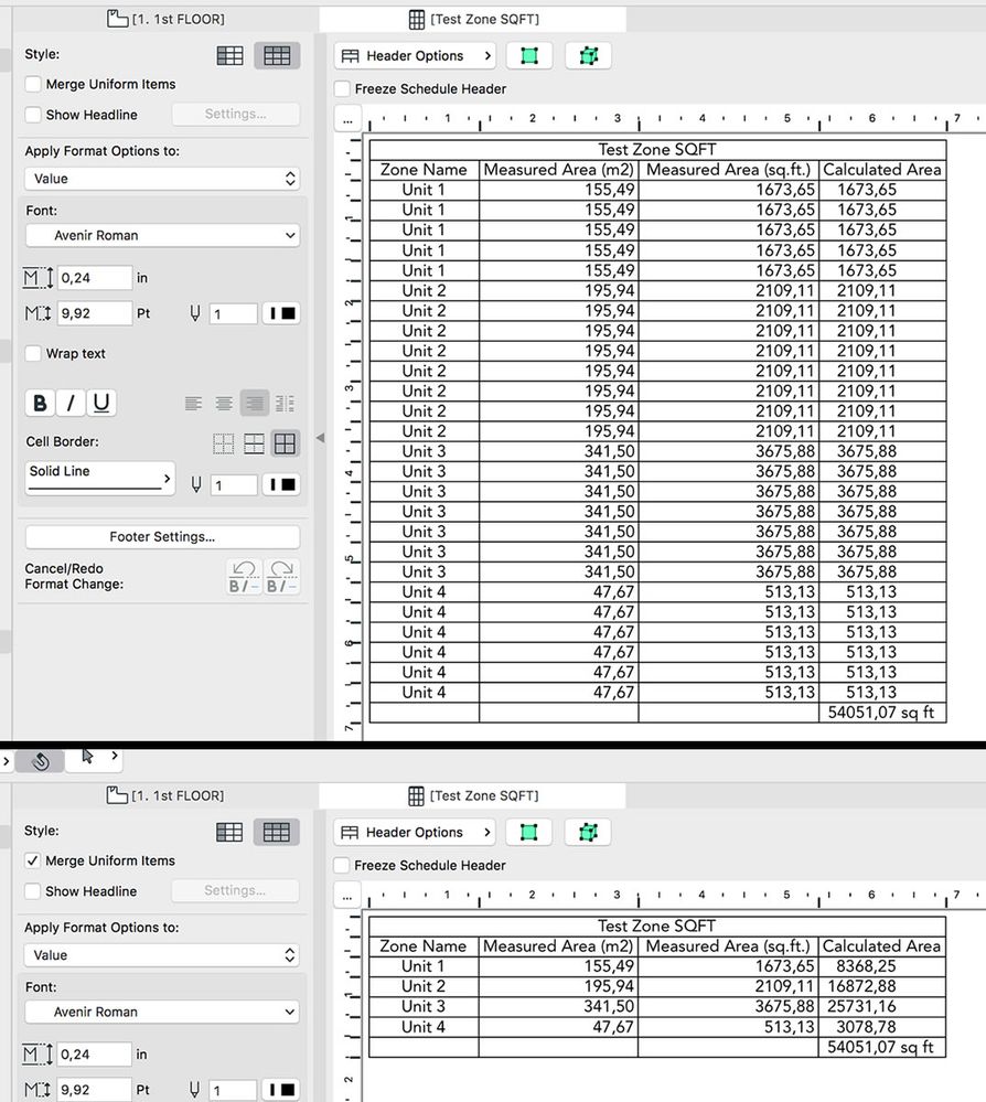

Thank you for your assistance. While I was able to create the variable and conversion calculation, there seems to be a unresolvable issue within ArchiCAD. It seems that once the value exceeds 1,000 SF, it simply displays the value as 1.00. Upon further testing to confirm the theory; area greater than 2,000 SF becomes 2.00, etc. (Not very useful!) So regrettably, the data is not reliable. I am attaching a few screen shots for reference. Thank you again!
(It would be so beneficial if ArchiCAD enhanced the functionality and usability of both the Scheduling Feature and Zone Tool. There is an inherent efficiency to have a schedule that can do basic math functions inside of ArchiCAD too. Simple things like addition, multiplication, suffixes, etc.) I know ArchiCAD 20 now has a Property Manager tool, but that still involves an external source to manipulate the data. Once a third party application needs to be introduced, such as Excel, the immediate, accurate flow of data to inform the design process is squelched.)

The variable in question is just a number — it should work. Attached is a screenshot of a simple schedule I put together with both columns for each unit — m2 and sq.ft. Representing an existing variable ROOM_AREA, as well as, new one called ROOM_AREA_SQFT equal to ROOM_AREA * 10.76391
I really do not like finding bugs in ArchiCAD and would prefer that not to be the case. Maybe I missed something in the variable definition.

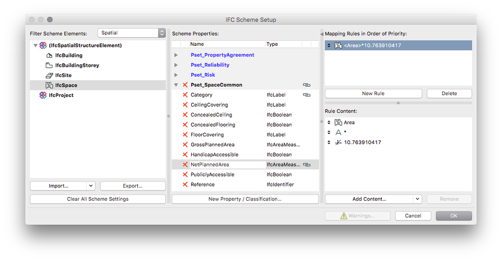

Here is a snap shot of just the IFC settings.

The Original Poster of this thread asked about Interactive Schedules, not about IFC scheme or object property setup, but your screenshot is of IFC Scheme Setup dialog window... I, currently, fail to see any correlation with this thread's topic.
You must be talking about something else entirely.
