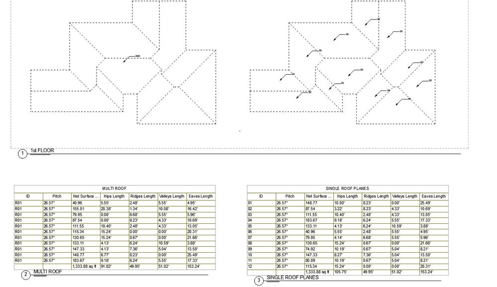

I am not getting accurate schedules for roofs.
In this example I have two identical roofs systems. One a multi roof and the other has been split into individual roofs.
Notice that the calculations are not all the same.
I did this test because my roof schedules are not reliable or accurate.
They also do not match manual calculations for lengths of hips, valleys, etc...Surface areas I think are ok I haven't manually tested them.
Am I doing something wrong? This example is not nearly so bad as others I am working on.

It is a bit of a worry that the multi-plane roof is calculating 11 surfaces when there is clearly 12.
It is adding surfaces 9 & 11 together but I can't see from the image which ones these are.
It seems to be getting everything else right (well consistent at least) except for the hip lengths but I can't make out which if any is correct.
It seems to have nothing to do with them being added together - the total for those tow adds to the total of the multi-plane surface (the second one).
If I had to guess I would say the multi-plane roof has the hips correct as there are two surfaces that don't have hips.
The single roof planes all have a value for hips.

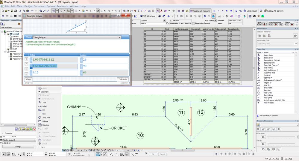

You can see the ID labels better in this picture.
Steve Jepson
Note roofs 11 and 12 for example:
The eaves, ridges, valleys are dimensioned. The superscript is the length on the slope. Nothings is correct except the eave length. This being the case, nothing in the schedule can be trusted.
I want this fixed.

Most of the figures are correct as you mentioned before - they show half the total length.
The worrying part here is the "hips" on 11 & 12 which are actually "gables" and as they are not touching other roof surfaces they should not be halved.
I can see now that roof planes 9 & 11 have exactly the same length eave (pitching line) which is why the multi-plane roof has added them together as one surface.
To me this is a bug but you could try unchecking the "show uniform entry as single entry" in the schedule.
Steve wrote:
Also I count ten hips on the roof - schedules have 9 on one 12 on the other.
The multi-plane roof is correct - remember it is adding two roof lanes together as one entry so in fact it is listing 10 not 9.
The single plane roofs are counting the gables as hips and adding the total lengths of gables and hips together for each surface which is why it is listing 12. It thinks every roof has a hip when in fact 2 of them only have a gable.

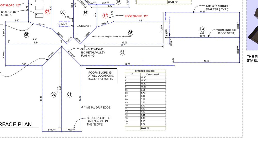

This picture is of another situation where it does not show the length of the eave correctly - see roof 3 - the schedule did not pick up the 10m length.

In the image attached everything seems to be OK except the multi-plane roof has added two surfaces together and the single planes have included the gables as hips.
Check the status of the edge of the roof and see if indeed they are set as hips or gables.
