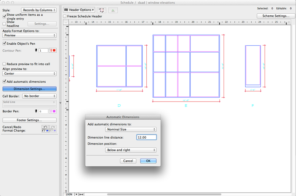

I am trying unsuccessfully to show the dimensions of each part of a storefront window in the preview pane of my window schedule. I can get it so show the overall dimension of the window unit, but I really need it to show the size of each individual pane. See attached screenshot and I'd appreciate any advice.

Select your window image in the schedule and then press the "Annotate" button that appears.
You will need to manually add these extra dimensions in.

Try as i might.... I can't get automatic dimensioning to work (Manual annotation works fine).
Note:
This is in AC15. Works fine in AC16.
Is this a know bug?

Your window objects must have 3D hotspots in specific locations for this to work.

When looking for hotspots, I realized the windows were all from the AC11 migration Library (it's a legacy project).
It works when I change them to AC15 Library windows.
Once again. Thank you.
