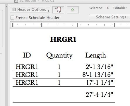

It seems that the schedule is picking up the length of the handrail not including the overhang - and the minimum overhang is 3/4". So, the length shown on the schedule is always at least 1 1/2" off. Does anyone know how to get the schedule to pick up the actual outside length of the handrail or guardrail?
The schedule is also showing the (inaccurate) length to a 1/16" accuracy, and at this point it would be better to be at a one inch accuracy. I changed all of the options in preferences to one inch, but the schedules are still showing 1/16". Does anyone know how to change the level of accuracy in the schedules?
