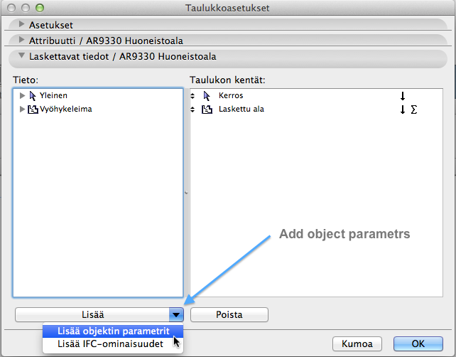

I'm severely editing the existing Graphisoft Zone Stamp object to allow a bespoke Masterplanning Zone Stamp (acres, hectares, sq ft, etc).
The code takes the basic
gross_area	= str (area_form, Temp_GrossArea)
line, applies a series of calculations on it and applies the results to various locally defined string variables (area_ft2, area_acre, etc). These are then written on screen as text when required.
We'd like the result to be output to schedules, but it seems schedules only access variables defined in the Parameters list of an object, not those created locally in an object's script. If I pre-define the variables in the Parameters list, they don't update on the fly to be schedulable (or at least, I don't know to make them).
Has anyone encountered this before (and found a solution)?

Hello,
You can add object parameters from here.
Then find your library, object and the desired parameters.

Thanks for making the screengrabs. We'd got that far already - the problem is it only lists variables defined in the Parameter list of the object, not those created locally in the 2D script for calculations.
(And adding in dummy blank variables in the parameter list doesn't seem to help).
Hello,
If the parameter is hidden with the check box it will not show in the list.
There are some possible workarounds;
- uncheck/unhide the parameter and save temporarily that way
- hide the parameter programmatically
- make a dummy object with same unhidden parameter and pick the parameter from there
- export the schedule and add the parameter by hand to the XML-file
Hope this helps
