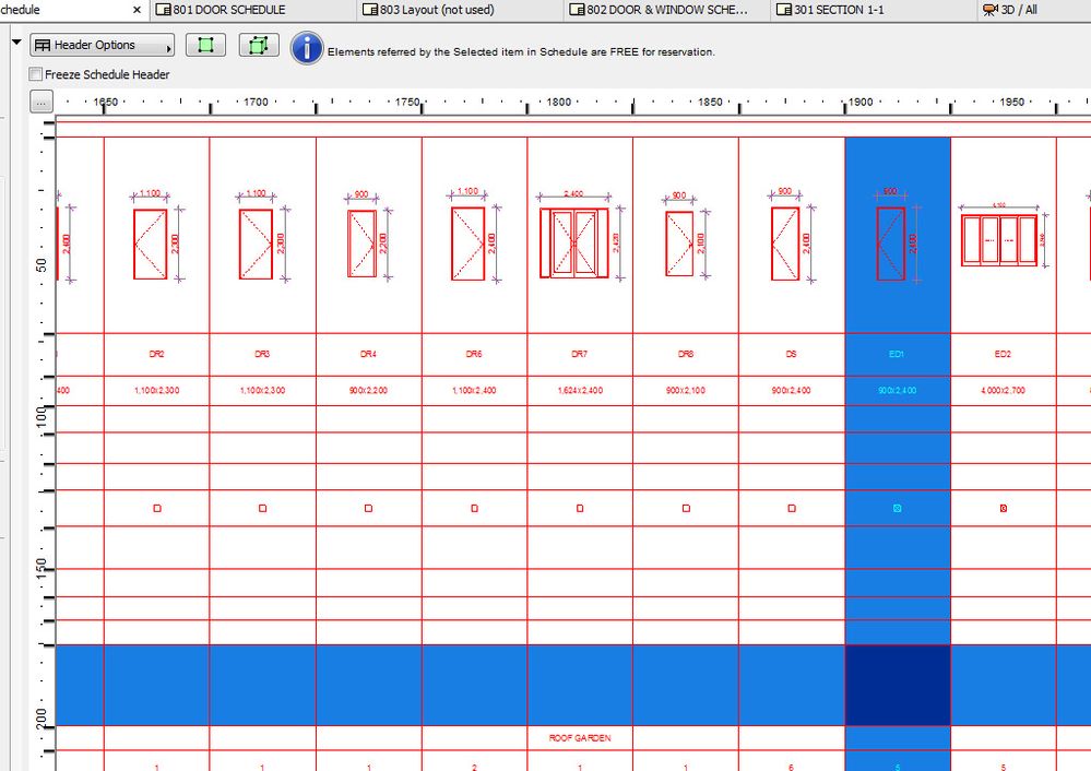

Hi All,
I am working on door schedule and am unable to type extra content in certain cells.
When I double click in it, it says "element locked", even after I reserve all elements.
All layers are all unlocked already too.
Please see attached of screenshot
Does anyone has any idea how to do this unlock?
Please advise
Thanks a lot

A guess: Maybe that element comes from a Hotlinked Module, so you will not be able to edit the element in the Schedule of the host Project.
You will be able to modify any part or parameter of that element only in the source file of the Hotlinked Module.
It's correct. Those doors are from MOD files. I forgot to mention that. I also guessed so.
There's no way if I wanna to have custom text in Schedule for doors of Mod file?
Thanks a lot
No, you will have to edit that information in each Hotlinked Module source file separately.
