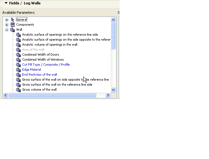

Does anyone know how to add additional parameters to the available parameters in the scheme settings of shcedules. (See attached) I've tried "Open object by subtype" but can't seem to find where these parameters a taken from.

Your screenshot is confusing given the question, as it is showing wall parameters. The Additional Parameters button - below the scrolling list that you show in your shot - is where you can add any parameter of an object for listing. But, this is only objects - there are no additional parameters for standard elements like walls, beams, etc.
Open by subtype and find one of your typical elements, or browse to find the element.

Thanks for the reply. I know about the Additional parameters but was unable to use them to shcedule properties of the wall. I would like to list things like log wall fasteners, among other things using a schedule. I know I can do it using list schemes but I wanted to try to find a way to do it with a schedule.
Karl Ottenstein
Not possible with a (interactive) schedule for any elements other than objects. Data from Property Objects linked to elements such as walls can only be extracted (AFAIK) via a list, as you've seen. The power of lists/property objects over schedules is huge - as is the possibility for great error, since one is scheduling things that do not physically exist in the model.
