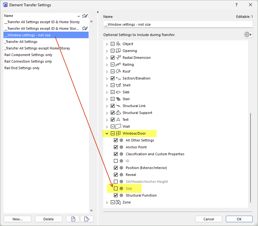

I just noticed this in just-installed latest AC 28 SPA; I had not noticed it in other 28s or 29s, but didn't verify now:
- historically you selected a say window, syringe-extract, pick some other window in the library view and syringe-inject, and it worked;
- in latest just-installed-and-updated 27 SPA the A (width) dimension, not sure about other parameters, won't transfer in syringe-inject in library folder view unless after syringe-extract you deselect the window, select it again, and then open settings to look up the other window. Took me a while.

Check the 'Element Transfer Setting' that you are using.
These can be set not to transfer particular parameters.
Door & window size is one of them.
