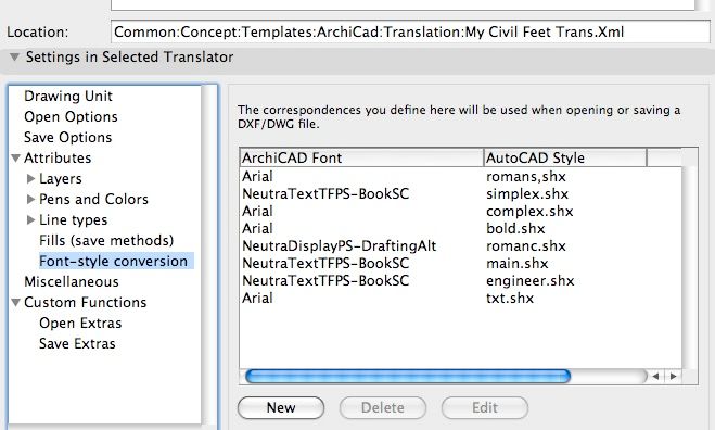

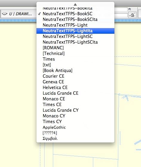

Finally decided to map the fonts (1st screen shot) coming from DWG to Archicad and avoid a long list of bracketed font names in Text Font drop window (2nd screen shot).
After the initial Skip All conformation fonts are not converted.
They default to an Apparent Arial font, even-though my default font conversion is not Arial!
What am I missing here?

I think that Archicad on the Mac defaults to Geneva when it can't find the target font it wants. You can change that in the Miscellaneous section of the DWG translator setup. It looks like Arial (which is a rip-off of Geneva, which in turn is a rip-off of Helvetica).
I would guess there might be some small error in the font naming on either side of the conversion table. This is particularly problematic with PS (PostScript) fonts, since for each font they come in styles (bold, italic etc) who reside in separate files. TrueType fonts have all styles in one file.
Also, I'm not completely sure about what Autocad 'styles' mean as opposed to 'fonts'. I notice your font names on the Autocad side are complete with file name extensions .shx You might try to just remove the extensions, since if your DWG has font mappings to TT fonts, they would not work. And start by having only one-to-one mappings to isolate the problem.
Then try setting the conversion table in your translator to some other font that you've got. If you get it to work that way, it's your font that's the issue. You might try getting a TrueType version of your Postscript target font and try that instead. There are PS to TT converters out there, Google is your friend.

1. Font conversion of TT font vs. my original use of PS fonts did not do anything and still did not work.
2. Removing shx extension from conversion did not do anything and still did not work.
3. XReadCfg.txt was looked at does not make any effect on imported files, besides with out more in depth understanding the characters I can not work on it.
4. Used the FontConv_mac.xml with TT font & shx modification did not do anything and still did not work.
5. I used different means of import:
Place External Drawing
Merge
Attach Xref
still no good.
I have given up after 3.5 hrs today and 5 hours during last week. Have reported to my reseller.
