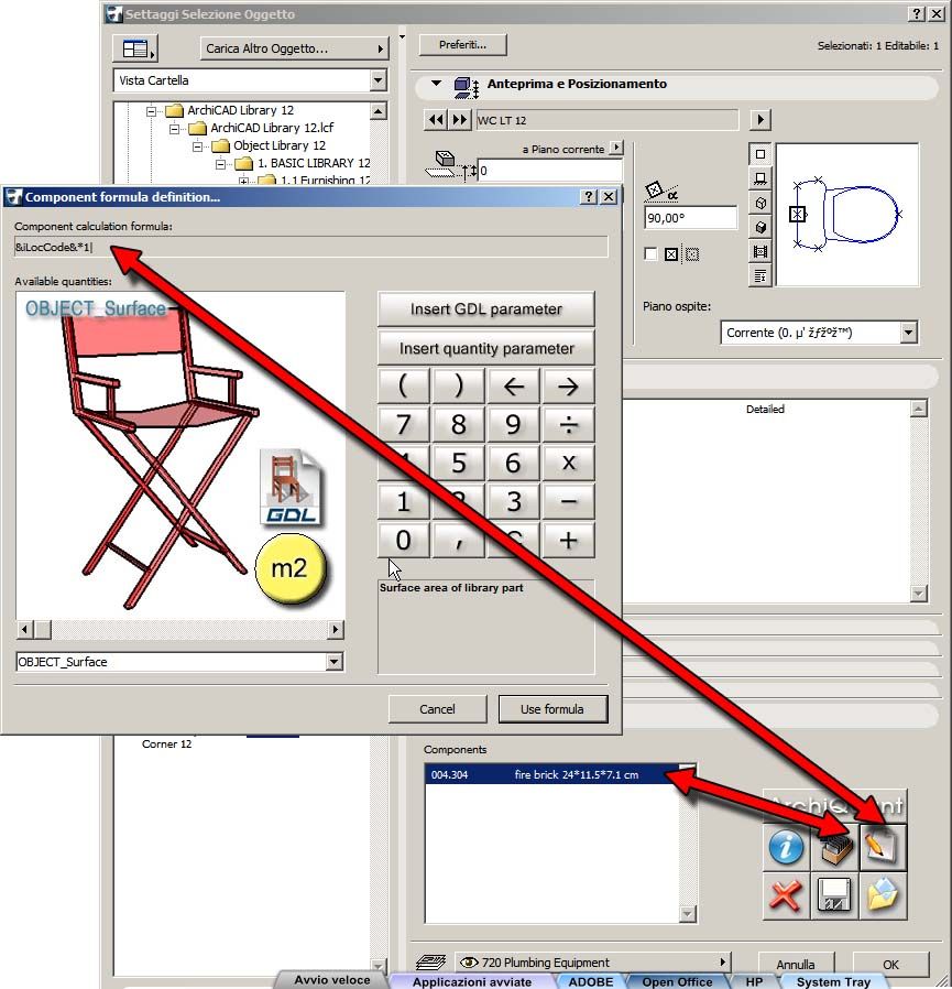

Dear Achille (I'm answering you both privately and here because maybe it could be useful also for the other ArchiCAD_Talkers),
I got your file (please, next time avoid to send me the PLA file but just a PLN) and I immediately check it!
I found the guilty component is assigned to an ArchiCAD Library Part named “WC LT 12” (I don’t know on which story it is because the names of the story in your project are in Greek language so they appears with strange characters on my Computer).
So:
1. I selected the object
2. I double-click on the ArchiCAD Object Tool icon in order to display its settings
3. I displayed the ArchiQuant Panel
4. I select the “guilty” component (004.304 fine brick 24x11,5x7.1) that, BTW, I don’t think it was what you was looking for… because I don’t understand why you need to assign brick component to a WC… but maybe I’m wrong (of course you can assign any component you desire to any ArchiCAD elements)
5. I displayed its formula by clicking in the Formula Definition button
6. Here I found you based the calculated quantity on the value of one of the GDL object parameters (one of the most interesting features of ArchiQuant!). This is the parameter named iLocCode (once again, probably you didn’t want to do this!). This is an hidden parameter (for localization function I suppose) that is always zero so… the final result is correct!
