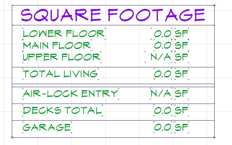

I am looking to Automate my Square Footage take-offs that are listed on the plan.
I have figured out a way to show the Zone area in a Table (by dragging the Zone Text into the pre-defined table), but this does not give an Automated Total.
What are others doing to "report" Living Area square footages?

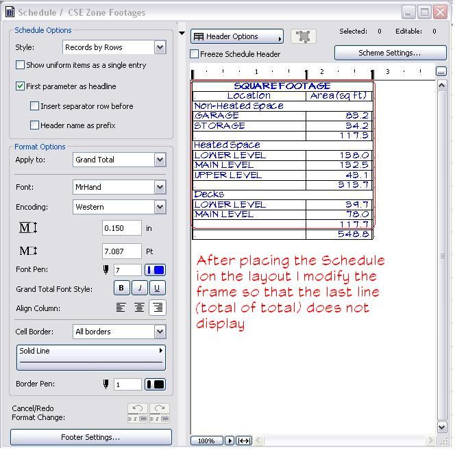

Thanks for responding to my message. With all the help I received, I finally figured out how to make the floor area schedule with totals etc., using Zones.
I am interested in the format of your original posted Schedule. How did you do that? Is your attached pic schedule interactive? How do you set it up to look like that with the numbers justified and pencil lines?
Thanks Greg.
The attached image in the original post was a NON-automated "dead" text schedule. The numbers were entered in manually.
The attached image in this post is of an Automated (being based on zones the zones must be updated if changed.) Element Schedule placed on a layout. This is the current schedule that I am using.

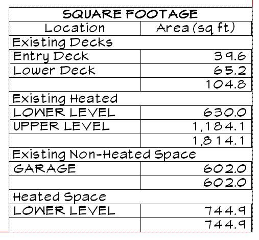

Here is another example of the Schedule. The zones for this example are using the three different zones that I usually use; Heated Space, Non-Heated Space & Decks.)

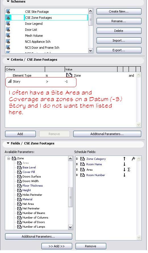

Here is the Scheme Settings
